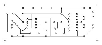

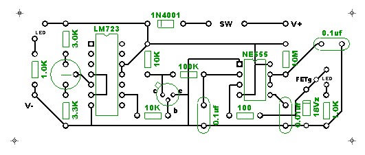

« on: October 07, 2005, 04:26:47 AM »
For those who are interested, here is a circuit board layout for Chris Greacen's Shunt Regulator (http://www.homepower.com/files/shuntregulator18.pdf). I recommend that you use sockets for the ICs and the transistor. The layout is sized for 1/6 or 1/4 watt resistors, small 100v ceramic caps and the 1K pot is a ceramic top-adjust type. Solder the 22v zener right to the FET. To make the project more user friendly you could panel-mount the pot, switch and the LEDs.  The main issue will be getting the trace image to print out correctly sized for the IC pins. Everything is available from digikey.com.
Some additional part number info:
 18v zener - 1N4746A (1 watt)
 22v zener - 1N5358B (5 watt)
 Higher power FET option: IRFB3207 (75v, 180a, much lower "on" resistance and still cheap at $5 US)
 LM723N
 NE555P
Component side:
Trace side:

Since you raise this subject again please help out here. I still can't get my shunt regulator to work properly. Nando gave this test procedure which I have done to debug but I think there is a light mistake in the test.
Nando's Test Procedure.

Sorry you are still having trouble, I thought you got it working.
It seems as though Nando has called the source the drain and vice versa, otherwise his test procedure is correct.
You seem to have the fet bit of the circuit working but it looks as though you may have trouble with the 555.
There is one issue that may be worth checking at this stage. You say that pin 2 of 555 is at .2v and collector of transistor is at 2/3 battery volts. this is odd as you have two 10k resistors in series, one at ground and one at battery volts so the junction(transistor collector) should be at half battery volts. Check the value of the 10 k resistors.
With pin 9 of LM723 low (Q1) turned off, collector of Q1 and pin 2 of 555 should be high.You say it is low, check .1uf capacitor on pin 2( most unlikely to be a problem). Check the track round pin 2 for short, if no problem it is most likely a damaged 555.
If your 555 is in a holder, remove it and check that pin2 voltage comes up.
For the 555 to generate a pulse, pin 2 has to be high, then taken low as Nando suggested. If it is already low for some reason you will not get a pulse when you short it to ground.
You can check the LM723 stage by adjusting the 1k pot and make sure pin 9 will go high or low depending on the setting.

Hi Flux,
Thanks for your guidance. You are right as always. Collector is at half battery voltage.
My readings are as follows:
Batt V = 14 V
Collector = 7 V
Pin 9 with 1 K pot all the way up to decrease Voltage shunted = 4 V
Pin 9 with 1 K pot all the way down to increase V shunted = 0.4 V
555 removed from holder - Pin 2 leg = 13 V ie up as you said so.
Pardon me but I am not sure how to check .1uf Capacitor on Pin 2 and how to check the track round Pin 2 for short.
The problem is pin 2 is always low. Does that mean the 555 is gone?
SeanChan.

Don't worry about checking the capacitor and pin 2 for shorts.
You have proved that they are ok by removing the 555 and seeing the volts come up.
Try a new 555 that seems likely to be the trouble. If that fails then the trouble is almost certainly something connected to a pin or between pins that shouldn't be.

Just one more thing to check, have a look at the voltage on pin 5 of 555.  This should be at 2/3 of supply volts. if for some reason this is low it may affect pin2.
A short, wrong connection or faulty capacitor to pin 5 would hold the reference low and may hold pin 2 down. I am not certain it would reflect on pin 2 voltage but it would prevent operation.

Finally debugged the Shunt Regulator. It was the NE 555 as Flux indicated. Swapped the NE 555 from the desulphater and when I tested the desulphater for 45 milliamps to confirm everything is ok it blew the multimeter fuse. Lucky I did'nt connect it just touch the probe to the battery, saw the needle fly past 250 milliamp and immediately let go. The regulator load now comes on when I shorted Pin 2 to ground as in Nando's test procedure and remains on for a second after.
