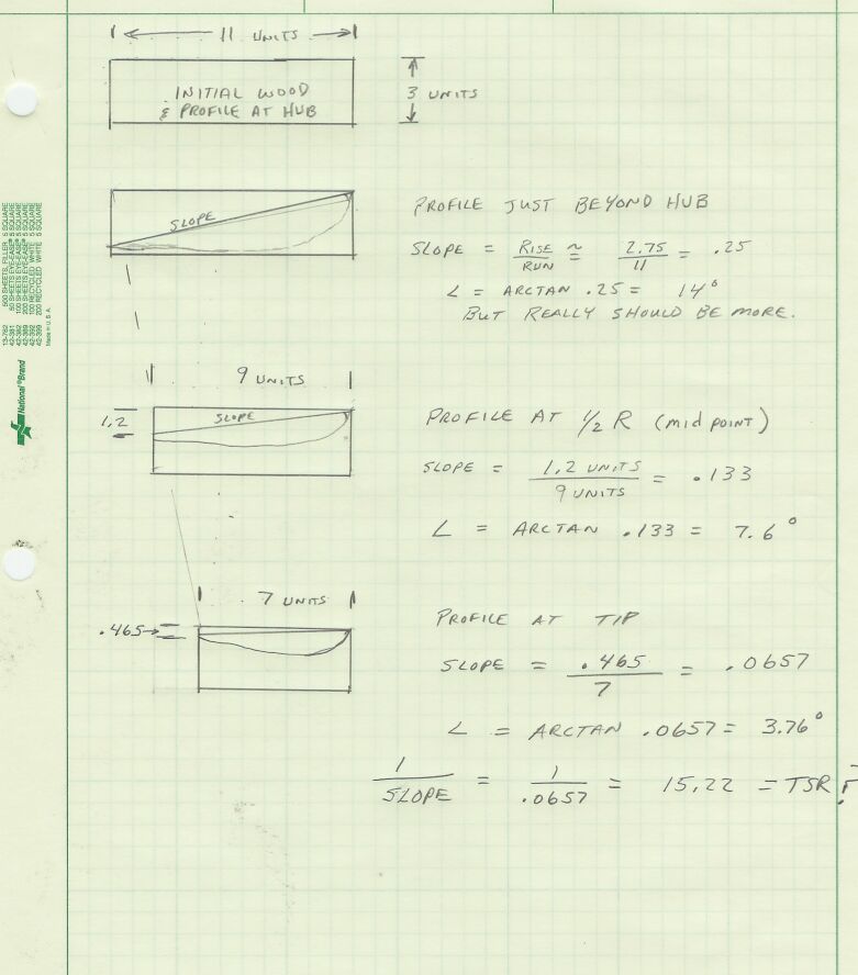

You said that the attack angle at the tip of the blade was 3 degrees and at the mid point it was 6 degrees.  If this is the absolute angle of slope, meaning there is no additional offsetting of the prop to add any additional angle of attack then I think  you have a very high apparent TSR prop.  As I understand it the angle of attack on your tip being 3 degrees gives a (1/tan 3 degrees) = 19:1 slope at the tip and at the midpoint (1/tan 6 degrees) = 9.5 : 1 slope. The tapering is consistant but as I understand it you have a tsr of 19.  Although you somewhat indicate you may be stalling the prop by stiff loading, I wonder if the prop is really trying to run quite a bit faster than your loading will allow.  I may be all wrong here and if so tell me but a 3 degree attack angle at the tip and 6 degrees at the 1/2 radius point is pretty shallow.  Am I all screwed up on my thinking here?

3 degrees at the tip would seem to indicate a tsr of near 6 to me. with the less than theoretical twist it will be dominated by the pitch angle at about 0.7 radius and this will make probably nearer tsr 7.
The low wind performance seems consistent with this. As Dan suggests it is stalled at higher winds and he has confirmed this with the series resistor. I like him would prefer the quiet life in high winds.  If you really have to screw the maximum out in high winds you have to live with something less peaceful and user friendly.
I don't follow how you arrived at a tsr of 19. That would probably need a negative pitch or setting angle at the tip and blades like match sticks.

Maybe Ill find out here where Im misunderstanding real TSR.  Ive added a drawing (not exactly to scale, but in the ballpark as a reference to the blade Dan made.)  After looking at it, it should be apparent how I came up with the notion of the high TSR. The TSR as I determined it in the attachment example is about 15.  Note I have not accounted for the difference in the chord line verses the face of the blade as in the example, and in the blades Ive made they are very close to the same. I have always thought that the tip TSR was the slope of the face of the blade relative to the direction of the oncoming wind.  After looking at some of the info published by Hugh the problem I may be having is not accounting for the the "apparent wind" direction caused by the blade rotating.  The odd thing is that I have always cut my blades following the approach shown in the attached picture, and when I measure non loaded RPM verses wind speed the prop is running at about the correct RPM (meaning the tip of the blade, if I thought I made a 6:1 TSR prop, was running 6X the speed of the oncoming wind.  I took this approach out of a couple of articles I found over the years, one being an old Mother Earth News published book called "Handbook of Homemade Power" and the other an old reprinted publication called "Homemade 6 Volt Wind-Electric Plants" originaly done by North Dakota Agrcultural College.
Please advise what Im doing wrong in determining the TSR. Thanks John
