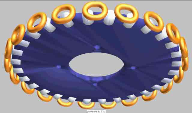

9" Radial Axial - Mags on Armature - Renderings | 9 comments (9 topical)

You are just reinventing the wheel but doing it in a way that is less effective than has been done for the last 100 years.
Alternators have been built that way from about 1880 onwards but most used wound fields until recently, Permanent magnets made little inroad until neo became available.
Never in that 100 or so years has anyone chose to leave out most of the coils and stick to this 4/3 ratio single layer winding. It just happens to suit axial air gap machines, it makes no sense in a radial iron cored machine.
The fundamental problem with iron cored machines is that they need very specialised magnetic steels to work acceptably with reasonably low loss. For the average person the only option is to adapt a commercial core ( motor conversion).
Wind is particularly demanding in that the efficiency needs to be highest in the lowest wind. All conventional alternators are designed for maximum efficiency at full load and under those conditions the iron losses are not serious and in fact you trade iron loss for copper loss with maximum efficiency when the iron and copper losses are equal.
A wind alternator with high iron loss doesn't work in low wind, something we fought hard with for many years and it was something of a revelation when we suddenly had magnets strong enough to get rid of the iron completely.
Yes it is perfectly possible to build what you propose but you need the patience and experience of Ed Lenz to put up with the physical challenges and even then you will have core material costing several times the magnets. If this is a labour of love but no cost project then avoid iron cores at all cost.

well, I'd rather hear if from you than to go to all the work of building it then discover it will only light one LED.
As always, appreciate your comments.

Under the "cut it to ribbons" section,
Never sink magnets in an iron hole.  It sort of shorts out the flux.
Seems like a lot of work (and more money) for basically a large diameter, very thin, motor conversion.

Hi Ghurd,
I just learned something then, didn't realize that burying the magnets would mess up the flux ... now that you pointed it out, it makes good sense.
I guess the plan is to let the magnets do their thing and just draw from that potential with copper windings moving through the path of the natural flux lines.
At the far end of that flux loop, iron (if placed along the natural flux path) helps bridge (or complete) the circuit to bring it back home to the (attracting) opposite pole. I can see now how "burying" just bridges ("shorts out") the circuit right at the magnet so it doesn't ever reach out to where it can be utilized by the windings.
It's bad enough having rather small magnets ... let alone squandering the potential that they do have. I can sure see how attracting poles placed at that far end of that loop (on the opposite side of the windings) helps tremendously.
Yup, dual rotor axial (with attracting, adjacent poles) is the way to go. I can still place the neos near the perimeter of the 9" disk (on just one rotor for now) and still come out way ahead (of anything like what I've shown above).
Flux ... Ghurd ... ya both saved me headaches, broken knuckles and some major disappointment in the results. So thank you for that ... ;)
If I ever go the radial route it should definitely be with another conversion.
They have shaft, bearings armature base and fields in a handy package and have some potential if the right one is chosen and it's done Zubbly style. I'd make sure I had access to a lathe and learn to pour resin if I were to ever try one again.
I'm convinced that a small axial designed in such a way as to allow more magnets to be added later would be a fun project that might be able to take advantage of the poor wind conditions here and still produce some usable energy.
Thanks for the input!
(Literally, "back to the drawing board")
